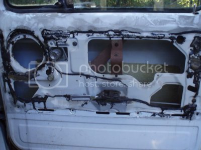

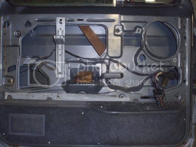

dont forget the front bumper:) Also the inner sheetmetal on the 87-91 power window door is the same as my 85 manual crank doors.
85 door
89 door
so you should be able to swap power windows in if you wanted to. The only difference i could see is the lower portion of the 87+ door had louvers that went behind the lower trim panel.
