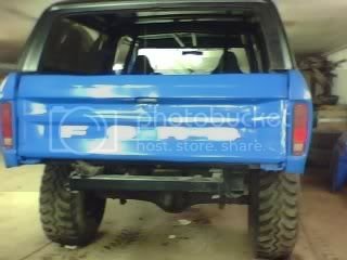

F 150 Tailgate pics in an 82
Source: by Mark L at http://www.4wheeloffroad.com/featuredvehicles/1982_ford_bronco/index.html
