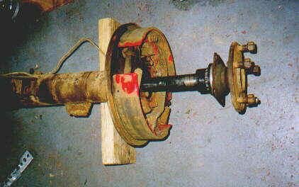

Some tips;
To a stuck axle shaft use a slide hammer, or turn the drums around backwards and start 3 lugnuts, and use the drum as a poor mans slidehammer. by Tim
Another method to remove the axles is to use a length of chain. Take one link and place it over a lug bolt and secure it with a large washer and lug nut. Now take the free end of the chain and make a whipping motion with it. The axle will come right out after about four or five whips. by Vince
When installing;
I just went thru the same thing last weekend. After sanding any rust on the axle bearing race and the end of the axle tube of the rear end I just picked up, I found that if I pushed the axle in with one hand and wiggled the splined end with the other hand it would go almost all the way in. Then a couple of taps with a rubber mallet and it was in. by Joe
