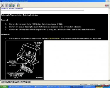

If you have the E4OD tranny;
Shift Indicator Adjustment in 92-96
Source: by Steve83 (Steve, That dirty old truck) at http://www.supermotors.net/registry/media/434182

Shift Indicator Removal in 92-96
Source: by Ford via miesk5 at SuperMotors.net

thanx that is the part i need, i also need a turn signal switch and that transmission indicator (cable), we never unhooked it when we dropped the column. do you have them parts and if so how much?
yo, I don't sell parts, I just help Jeff's and others sell the parts,
For the ind cable; try LMC or
Chris had same prob;
Got a new one from Ford, about 20 bucks, and the quality of this one is much better, the cable is protected much better, and the spring of course, has spring to it
try a yard search or local tranny shop to save some $
same for switch
