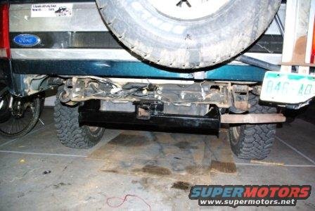

Start looking at junk yards those bumpers will never be straight again. Mine live elsewhere for the same reason. You need ot get yourself some real recovery points if you are going to continue to play. You are LUCKY that the ball did not come off and go through the truck that snatched you out.

That is better. The rear bumper is still not made for that much force. And the receiver should fit. I got mine off of an older F250, you can measue the frame rails to be sure. I went around the junk yard for about an hour measuring every trck that had a receiver to find one that fit. It now pretends to be my back bumper- It looks better with the plasic piece back on.
if you have access to a welder and some steel you can just grab a chunk of pipe weld on a couple of brackets to mount it with and cap the ends and voila you have a bumper, you could even drill and tap it to accept air hose fittings and hook it up to an on board air compressor.
