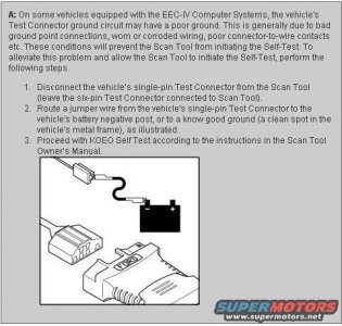

So; Scan Tool Won’t Initiate Self-Tests Troubleshooting in EEC-IV; SIG-RTN, Self-Test Output circuit, etc.
Source: by Ryan M (Fireguy50) at http://fordfuelinjection.com/index.php?p=44
He has a lot of thAngs to ck in there; but batty voltage is a prime prob.
Try this; it yaks about a scan tool; but swap that for the type of self test process you are using such as the Voltmeter or da cel)
