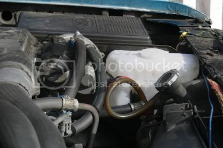

The old setup with the vaporizer located where the stock tank is:

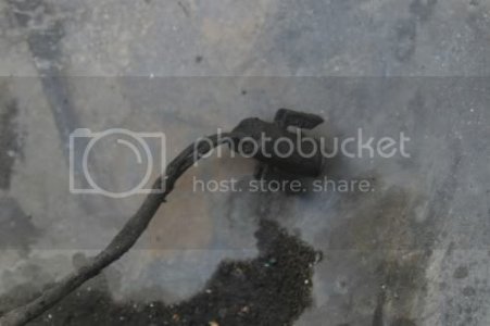

The Old stock electrical connector for the pump:

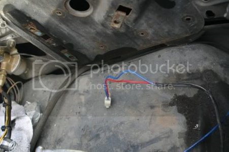

The new connector for the new pump:

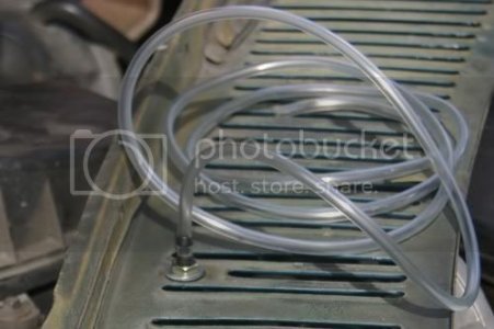

The "generic nozzle" mounted in the stock hole.

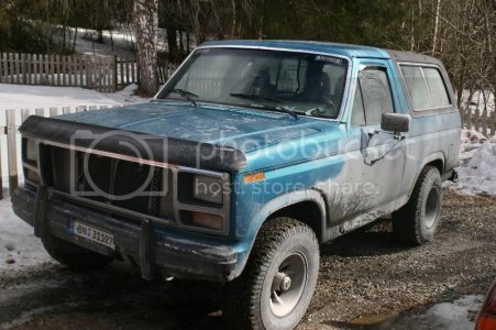

Lastly a picture of my little bronco.
There havent been many cosmetical changes to the car since i got it, but ive done a lot of work on it.
but afterall i dont drive the car because its pretty, i drive it because its awesome.

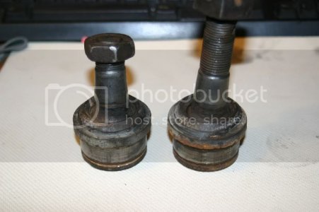

The old balljoints:
The rubber parts of it just crumbled away when i took the knuckle off, and they are totaly dry.
