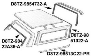

Diagrams, 78-96 w/Ford part numbers;
D8TZ-9851322-A Removable Roof Front Seal On fiberglass roof;
D8TZ-98513C22-PR Removable Roof Side Panel Seals on 78-79;
D8TZ-9854732-A Front Roof Rear Seal on metal roof on 78-79;
E1TZ-98422A20-A Back Window Glass Lower Side Run, RH or LH on 78-96
Source: by bwautoparts.com via web.archive.org
