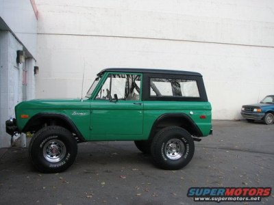

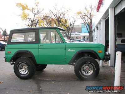

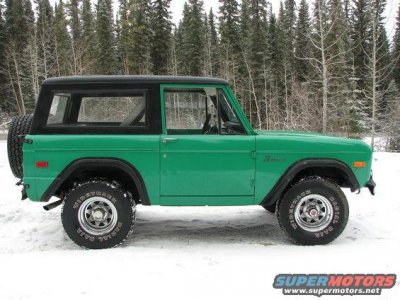

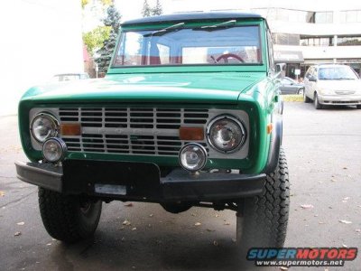

Cage 3 inch suspension. I went from 32 inch tires to 35 inch tires.
Rides really well!
Before:
After:

That looks really nice! I'm curious, did you do a 3" sus lift only? You don't have any body lift? I would have thought 35s would rub without a body lift.........are they 35x12.50s?
Thanks! It is just a suspension lift. the truck is "cut" so that is why they work. Yes, they are 35x12.5r15 and no rubbing!
