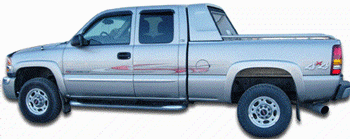

I can't believe that top went for over $900 after shipping!
Someone needs to build that thing once more.

All I need are some good pictures of how the STC one's work without it I'd have to design somethign completeley from scratch, and it'd be a real pain in the ass.
I have one idea of how to make one completely of my own design but I'll have to wait till I have time to work on it. Making the folding bar assembly is cake the hard part is the fastening system that keeps water out, I'm thinking of making the top hang down maybe an inch over the quarter panels zipping to a rail you'd mount in place of your old top all the way around, only problem is you'd need some way to ensure water won't get in along the top, I'll mess around a bit and let you'se know what I come up with. Also, it might be best not to make the bars fold, that way when the top is up you can put large items in the back, the STC top sits on top of the tailgate when down. If I were to make the bar in the back correctly it could function with the rear window.

I think I've come up with something. Completely different from STC's product, this would fold FORWARD and when folded would be a very short cloth extension of the metal roof, I've also figured out a way to make a cable system so you can use a small hand crank (or even an electric motor) to open and close the roof. The whole thing should mount using all factory holes. there will be 3 rails, one on each bed rail and one in the center on top. Below is a crappy MS Paint drawing of the design.
theres nothing chiseled in stone yet and I didn't bother showing how the cable system will function but I've already got that most of the way figured out.

Thats a really fancy system, might be hard to make without having one to work from. Though you could probably modify one of theirs to fit a bronco with out too much work.
