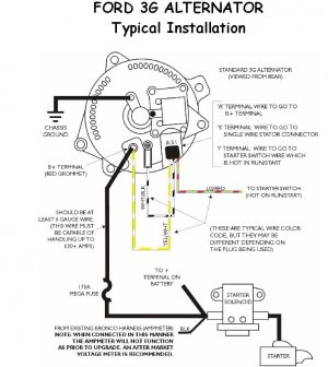

hey guys, i want to upgrade the alternator on my 87 351 bronco
if i get a single wire alternator, do i just run a 4 gauge wire from the stud to the starter relay and leave all the other wires hanging?
(i am plowing with this truck, and the hydraulics take a lot of juice)
thanks

I used 2 4 gauge wires off the back of the alt. 1 to the starter solenoid and 1 straight to the battery. ITs complete over ****.
x1 4ga wire of the back of a 3g alt to the starter solenoid is plenty. I got my 3g from O'reilly and its the part # used in the 1994 Mustang 5.0. fit great with the normal bracket grinding required.

forgot to ask, with the 3G alternator, i do not need to hook the existing wires up?

Yes you will need to hook up the existing gray plug in the new 3g.
