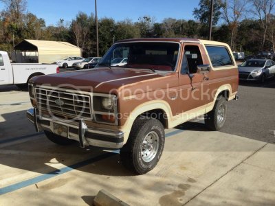

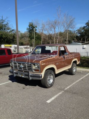

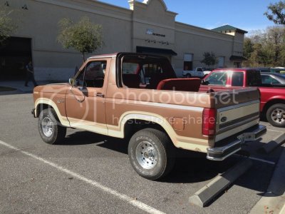

Of course, what is a thread without pics right?! Allow me to introduce my baby to you all...
The Big ******

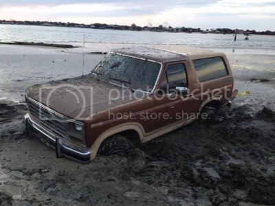

OOOPS!!!!

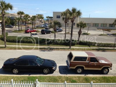

Here she is with my other baby, a 96' Impala SS, outside my house. You can see the ocean from my porch :D//>

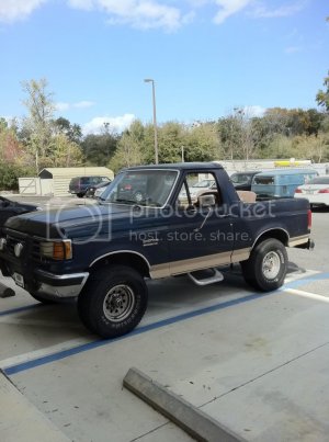

And here's my old gal, Betty The Bronco, may she RIP :((

Welcome to the Zone :D/ >. Nice looking truck. Take care of that rust on the 1/4 panel before it gets out of hand. The answer is yes. The floor design is the same but you may not find the hole are completely compatible. If you have to drill new holes, be sure to add some reinforcement like a heavy duty shoulder washer on the under side of the floorboard. Look at the current place a seat bolts down for ideas on what to use for reinforcement. Basically you want to make sure the seat bolt doesn't rip through the floorboard. I did that with my 83 so I could use a set of Expedition seats. You might want to take the seat with the frame, even if it means you will have to change the seat covering.
