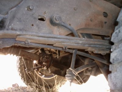

They are pretty vulnerable, I bent the crap out of mine in a bunch of loose rocks in New Mexico.
Those end links are about $30 each. I just removed the bar and have not yet put it back on. Didn't see much sense in spending $60 to replace the links when I will have to get longer ones after I lift the truck. At the stock height, I have not noticed a difference in handling. I will wait to see how it handles after the lift to decide wether or not to put it back on.
This is the area where I bent them up.
