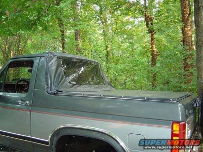

You seek this type?
by Gacknar in his 86
