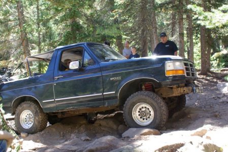

It could have somethinng to do with situations like this- notice the big a$$ rock at the rear axle.

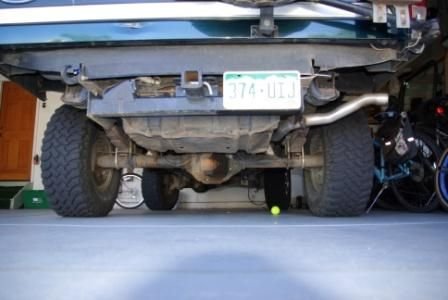

This year I hope I solved that issue by doing this-
Notice there is nothing beloy the axle now, hope the slows down the shock damage.

haha well you could still get by with the front shocks! I forgot the rear shocks are kinda put out there huh..
How did you raise the bolt point on the rear ones? My buddy is talking about throwing a 9" rear under mine and if so, I wouldn't mind toying around with your idea..
One thing I thought about though is the shcoks are both forward facing. I noticed on new trucks/suv that the driver shock is forward facing and the passanger shock is rear facing. Wonder how this helps with ride comfort betwheen the two setups as I may try to change mine around..
I just cut off the mounting brackets and welded a new set up higher on the axle.
