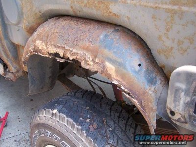

We've been battling that wheel lip surface rust for a few years now too; You will most lilely have much more rust in the inner fender area - it is spot welded to the outer 1/4 panel and this method causes all the 1/4 panel rust problems;
& also inside the 1/4 in the area where you removed the rust; I plan to use Patch Panels w/body adhesive soon.

I had one bubble aboove the wheel well (WW) trim moulding last fall. I removed da moulding and sand3d da bubble down, looked ok, was just that moisture;
but, rusted out WW metal lip sections came with the paint. I lost approx. 4 incles of lip metal. I took out all the rust I could see and ended w/clean lip metal at the "edge" of the 1/4 panel; On your WW moulding. imagine all metal gone where it attaches with the screws. It disintegrated in my hands! All due to the assy process where Ford spot welded inner panel to the 1/4 panel.
Here is what I face in the spring; Patch Panel Installation, Jeff's Bronco Graveyard in a 94
Source: by R94BroncoXLT (Ryan)
I'll get the inner panel as well and do it all.
Wheel Well Repair pics in an 86
Source: by Xris at http://www.supermotors.net/vehicles/registry/5183/57487
This pic shows the inner rust at lip as well as where it meets the cargo area's floor pan "tub"

I hate to burst your bubbles, but there is no way to permanently fix those spots except to remove the rusted area and replace it with new metal. It will look good for a while but next year it will be right back. Meisk5 is right about the cause, it is NOT moisture under the paint. It is, as shown so well in your pictures, caused by the spot welds. The cause by using the body as a ground conductor and running small amounts of current through the weld, commonly known as "Galvanic Action". If you repair the panels by welding in new pieces it will happen again, that is why Meisk5 is using body adhesive. Combine that with a flanged panel and blind rivets in predimpled holes and "WALLAH" nearly permanent fix. Treating the inside of the metal with undercoat will go a long way also. Then go on a yearly rust patrol, because in the words of some real wise person, "Rust NEVER sleeps".
