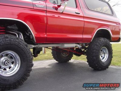

I got the Hedmah fender exit's on my 78 Bronco, they were some of the easiest header's I've installed. It took me about half the day. You may have to move your brake line's out of the way on the driver's side. But I didn't have to do anything with the steering shaft.

Thanks for all the tips and info. And Freak, your Bronco puts mine to shame. :) /emoticons/[email protected] 2x" width="20" height="20" /> Anyways, got them in and they sound great. Nice deep and NON-raspy sound. Installation was easy, besides my shock mount was kinda stubborn. Thinds were made a bit easier since I have a hoist, made getting the pass side rear manifold bolts slick.
So thanks again for the help. Next comes the lift kit. I'm sick of not being able to play hard and the tires rub the headers at full turn. So at least now I have a better reason to get off my arss and get it put in.
BTW, I'll post pics once it stop raining around here.

These aren't Hedman's they're the stainless Doug Thorley's that L&L sells. They angle the collector down a bit and while I *could* have had the straightpipe bent upwards to tuck it in along the frame it just wan't a very big deal to me so I never bothered with this one. I used the same kit on a different 78' and instead of having the straightpipe bent I just used an 8" length of flexpipe right at the collector to bend it up along the frame. I initially had some issues with the collector whacking the body-mount on the passenger side but after re-grinding the flanges the prob went away, dunno how the length of the Hedman's stacks up so it may not be an issue.
One thing that you'll notice right away is that once you move the exhaust out from between the framerails you have a LOT more space to work with. Things like changing the started take all of 5 min and you're not hassling with hot exhaust pipes while you work. Fenderwell exits are THE way to go in my book.
