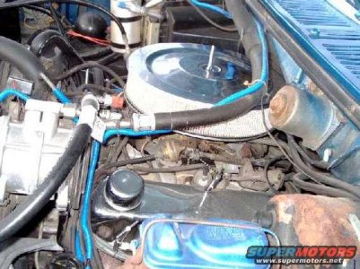

try the scrubbing bubbles, it's like $4.00 for a can at WalMart. You can use a spray bottle with water to clean off the bubbles after they do their job for a minute or so. I actually used that stuff to clean my engine tranny and t-case while they were out of the Bronco. I have an assortment of brushes for gunsmithing, like a toothbrush size and smaller, for those tight areas. It helps to use the brush along with the bubbles. You can also dress up the hoses and plastic parts with CD engine detailer. It's like Armor-All, just spray it on. I think I have a pic of my old 351W H.O. engine after cleaning it with these items:
