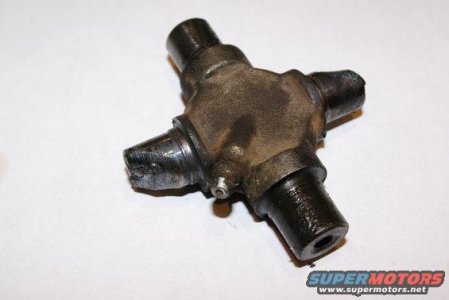

Those bastard ujoints (yes that is what they all called) are about twice the price of regular ones. I also managed to break the 1310 section twice last year. Looked like this

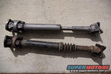

Needless to say I would stay away from them. Just got this a week ago :wub:
All 1350s :D /emoticons/[email protected] 2x" width="20" height="20" />
