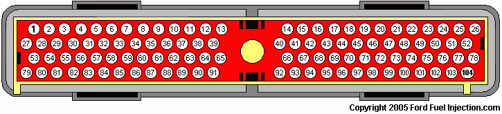

Timing Pointer & CKP/CPS (misfire) sensor used only on OBD-II engines. The lower L pulley is a factory idler where the air pump used to mount
    Disconnect PCM. Inspect for damaged or pushed out pins, corrosion, loose wires, etc. Service as necessary.
Measure resistance of MD circuit at the MD sensor harness connector and EEC Pin 59 (MD) DG/LG wire.
Measure resistance of misfire RTN circuit at the MD sensor harness connector and EEC Pin 6 (SIG RTN) Bk/Y wire.
> Are resistance measurements less than 5.0 ohms?
No: SERVICE open circuit
Yes: Key off.
MD sensor disconnected.
PCM disconnected.
Key on, engine off.
Measure voltage from EEC Pin 59 (DG/LG wire) to EEC Pins 51 (Bk/W wire, GND) and 55 (Y wire, KAPWR) at the EEC vehicle harness connector.
> Is voltage less than 1.0 volt?
No: SERVICE MD circuit for short to power.
Yes: Key off.
PCM disconnected.
Measure resistance from EEC Pin 59 (DG/LG wire) to EEC Pins 51 (Bk/W wire), 55 (Y wire) and 6 (Bk/Y wire).
> Is EVERY resistance greater than 10,000 ohms?
No: SERVICE MD circuit for short to GND or SIG RTN
Yes: Key off.
EEC disconnected.
Measure resistance from EEC Pin 59 (DG/LG wire) to each of the following pins: 51 (Bk/W wire), 55 (Y wire), 71 (R wire), 97 (R wire). Then measure from pin 6 (Bk/Y wire), to 23 (Or/R wire).
> Is EVERY resistance greater than 500 ohms?
No: REPLACE EEC.
Yes: Key off.
Reconnect EEC & MD sensor.
DVOM on AC scale (to monitor less than 5.0 volts).
Measure voltage from MD circuit 59 (DG/LG wire) to GND circuits 51 (Bk/W wire) and 103 (Bk/W wire) at taps in those wires while running engine at varying rpm.
> Does AC voltage vary greater than 0.1 volt AC?
Yes: Replace EEC.
No: Is the MD sensor trigger wheel damaged, i.e., loose or misaligned?
Yes: Replace or service trigger wheel as required.
No: Replace sensor.
