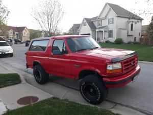

I recently bought a 1995 ford bronco and got a pretty good deal on it and so far i love the thing. Its had a fair amount of work done on it, lifted, trans rebuild, and everything under the hood including the engine. From the paperwork i have a 5.0 R&R engine with the paperwork saying there was a $3k downpayment on the motor. My issue currently is that im not getting power where i feel i should. On the slightest incline i struggle to get faster than 35mph and when its hot i really struggle. The shifting feels a little off and the power is being delivered at awkward times. Someone mentioned a cold air intake but i was seeing if anyone out there understands whats going on and can help me out because i love the thing but i live in kansas and its barely warm out and im struggling so im not sure it can survive a summer like this. Any questions/suggestions/answers?
Bronco95ks
May 15, 2020
Kansas
Recently had an incident with the hood and the garage door so now im running 2 hoodpins and a partially folded hood and ive swapped out the mirrors for some old school manual folding mirrors. Running no exhaust so its nice n loud. Super clean inside. I love the thing and always open to ideas and suggestions. Im here to learn
Good looking rig except for the cancer. My 1996 Sport suffered the same fate in Massachusetts. I wish I‘d had my 1996 Sport in AZ and it didn’t rot away. My 87 is rust free, but has some rock rash from proper off-roading.

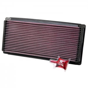

So good news. I installed a couple parts and learned i had a bad spark plug and some of the sparkplug wires were crossed. New wires, couple other parts and now she runs like a dream. Its like a whole new car. Im so ******** happy with it. I guess my next question is..is the k&n $320 air intake worth it or is there some cheaper or better options. I also learned i have a 5.0 small block high output engine so any suggestions on more power and cleaner shifting
Bronco95ks
May 15, 2020
Kansas
Been told yes and no. Best price is getting the trick flow version.
My best set up I've used is the 460/300 air ducting with the k&n drop in and and the best results
Can you do me a favor and send the link to the k&n your using?
