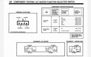

looks like the high low leaver wiring got to hot and melted the connector wires. I looked around for one at a pick and pull and it seems to not only be mine. The others I found had less damage but still had burn on the plastic.. so what could be the issue.
To T,
If your blower blew on high in every position, a resistor(s) in resistor pack went bad due to age and high current flow. New resistors are available in most parts stores.
Location pic in an 83; "...After replacing the muffler, I could hear that the blower would only run at HI speed, so I bought a new resistor.
When I pulled the old one, I saw why it had overheated - a squirrel nest in the squirrel cage. .." by Steve
