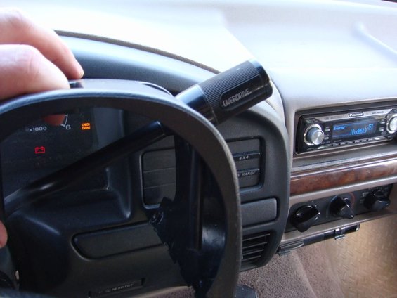

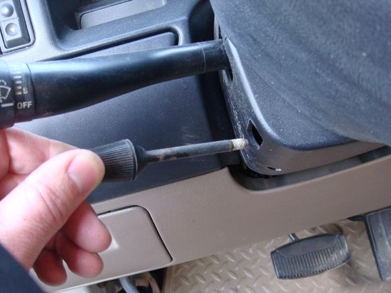

Start by removing the tilt wheel lever, it unscrews.
http://www.supermotors.net/getfile/624875/fullsize/dsc00346.jpg

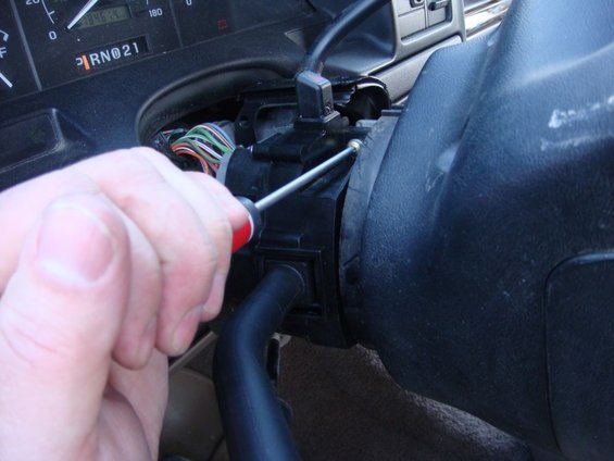

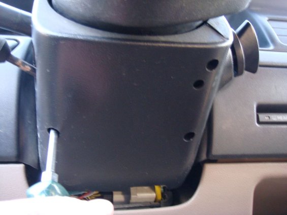

Next removing the cover, there are 4 phillips type screws to remove, 3 of which are access on the bottom
http://www.supermotors.net/getfile/624874/fullsize/dsc00345.jpg

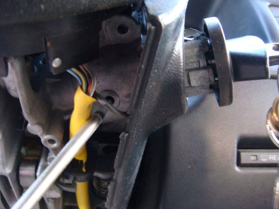

The fourth one is locked on the back right, you can see the ***** hole better in this picture.
http://www.supermotors.net/getfile/624882/fullsize/dsc00354.jpg

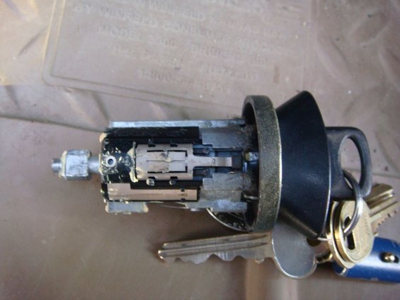

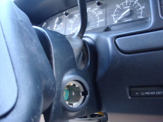

You'll need to remove the ignition tumbler, while pushing on the release bearing turn the key to the run position, this will release the tumbler and it will slide right out.
http://www.supermotors.net/getfile/624876/fullsize/dsc00347.jpg
http://www.supermotors.net/getfile/624885/fullsize/dsc00357.jpg
http://www.supermotors.net/getfile/624877/fullsize/dsc00348.jpg
Slide the top cover up and over the gear selector.
http://www.supermotors.net/getfile/624883/fullsize/dsc00355.jpg

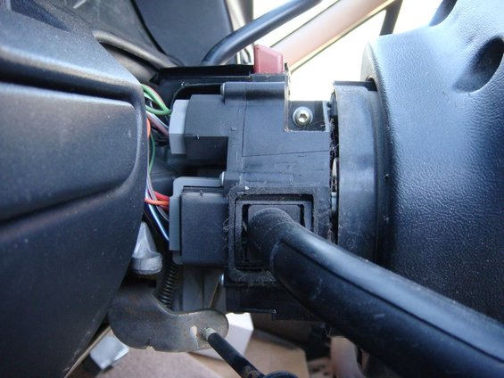

Remove the 2 torx screws that hold the switch in place and disconnect the 2 wire harnesses on the back of it.
http://www.supermotors.net/getfile/624878/fullsize/dsc00350.jpg
http://www.supermotors.net/getfile/624880/fullsize/dsc00352.jpg
Install in reverse and your done.
