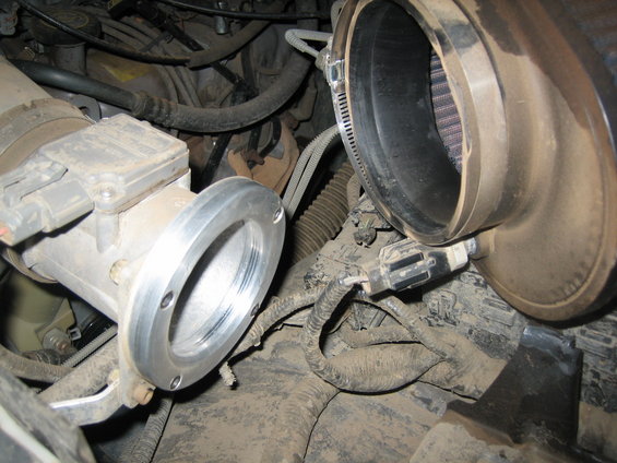

Ok I have seen the installs for the twin tube intakes but never for the singles, it's really simple, so here goes:
***It was late so I didn't get measurements but I can post up whatever you want upon request***
First off, I got a filter for a '99 Escalade 6.0L. It has the hole for the O2 sensor and is plenty big for a 5.8
order for it to work you will need to machine a stack that the filter clamps onto and that will bolt up to the MAF sensor housing. I used a 3/4 chunk of alum, 2 holesaws and a lathe to chamfer it and a mill for the 4 bolt holes. (I'm sure a drill press will work fine too)
http://www.supermotors.net/getfile/453100/fullsize/img_1427.jpg

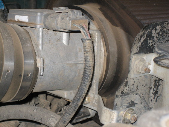

In the bottom of this picture you can see the aluminum bracket that holds the MAF housing to the coolant tank holder (technical term)
http://www.supermotors.net/getfile/453099/fullsize/img_1425.jpg

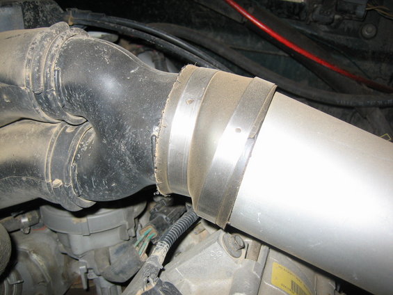

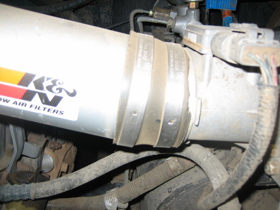

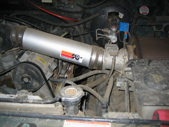

Now you could stick with the factory air tube like I did for a while or you could find some pipe and make a cooler looking one like I have now. 3.5" dia. pipe, painted it, added the sticker. I got the silicone black things at a hardware store and have no idea what they're called, but they came with the hose clamps.
