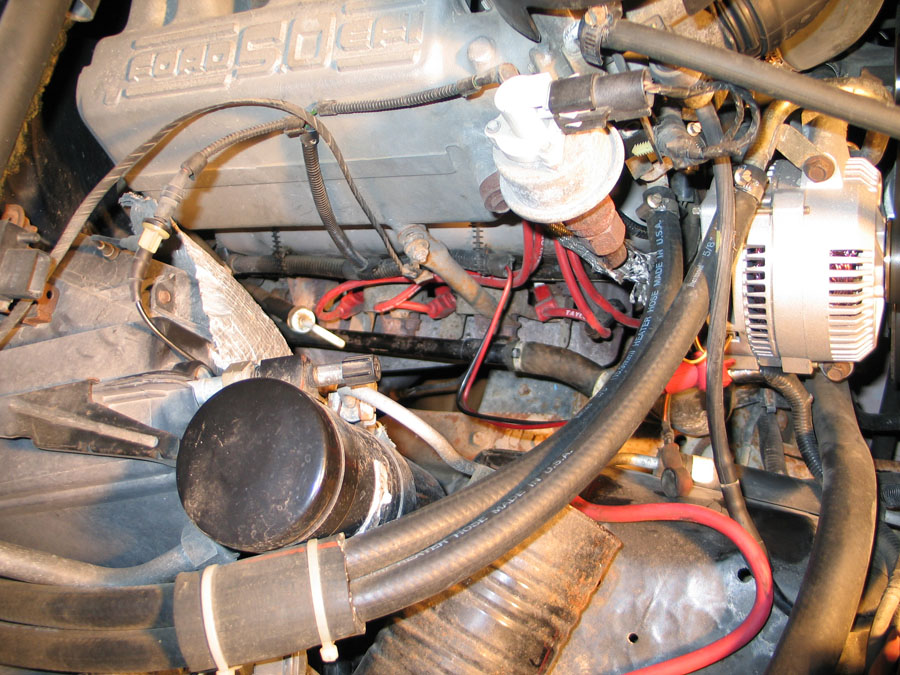

here is a pic of it, I think! 94 5.8 by joelb23
and a grnd strp pic on a 94 by Sandy - look straight down below the "F" in the EFI script on top of int man.
and a closer view; has large nu- i removed all this, cleaned and applied Electrical silicone grease
& http://www.supermotors.net/getfile/463251/.../pass_close.jpg
