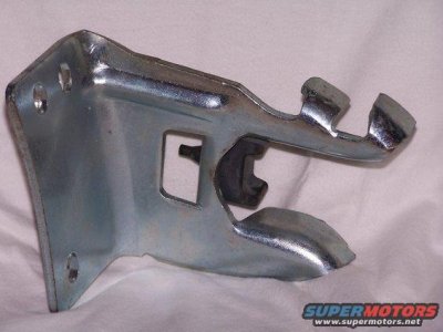

For the tailgate, you probably want to use the stock support for inside the tailgate. It's just way too easy to install the stock brace to even consider making one. It has to tie into the structure inside of the tailgate to distribute the load. It can be unbolted from one truck & bolted into the next. If you add a carrier to a Bronco that never had one, use that support.
Here's a pic of the tailgate support (Pic borrowed from Dustball, the last I heard he's still selling this part). The top is at the left. You can see the 3 holes for the latch. The other holes mount to the structure inside of the tailgate.

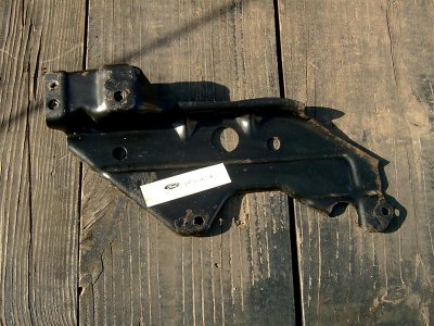

There is also a support inside the fender, but it can't be removed from a good truck without a lot of work/damage. It's better to get that part from a truck that's being parted out, or to make a new one. If you use the stock fender support, you may have to cut it to fit it into place.
My internal fender supports are made from 3/16 plate, bent to fit. They are each bent twice with 2 flats that contact the fender at the bolt holes, & a center portion that doesn't contact around the curve. The edges are ground round, to try to keep from them punching through. They don't connect to each other or to the existing internal bracing like the stock brace does, but it would be stronger if they did. I may still modify them to do so.
It's easier to make the supports to fit the shape & hole pattern of the carrier hinge brackets. The hinges are the same shape as the fender, & it's much simpler to work with the hinges on the bench than trying to bend the steel to match the truck.

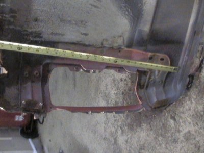

Here is a sideways view of the stock support inside the rear fender from Mickaila's Bronco build.
Quote:
Originally Posted by mickaila
Here is an overall view, again, ITS UP SIDE DOWN, as you can see the top portion of the panel (where the soft top sits) on the ground presently:
And a shot through the taillight opening of one of my homebuilt braces (It's getting rusty in there, it should have been painted. Even inside of the quarter panel in California
). You can see how it isn't formed to the fender at the curve, but takes a straight line across.

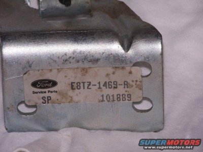

Be aware that the design of the latch changed (I think the break is between 89 & 90, but I'm not sure). The older ones have a long release lever & sort of a hook strike, while the newer ones have a short release handle & a latch mechanism similar to the doors. Make sure that the strike you buy matches your carrier.
My experience is with a 90. I have heard that the hinge brackets are a different shape to match the rear fenders of 78-79s, 80-86s, & 87-96s, so be sure to use the matching hinge brackets for your fenders. I have also heard that the carriers themselves will swap between 78-79s, 80-86s & 87-96s if you use the correct hinge brackets, but don't know that personally.
They also went from 2 holes mounting the latch to 3 at some point. The 2 & 3 hole parts may work with each other, but you might have to drill a 3rd hole & add a nut behind. My internal tailgate brace had only 2 holes. They matched 2 of the strike holes, & I drilled the 3rd.
Here's an earlier strike (89 & before?):
Somewhere there's a pic of the later strike (90 & later?) When I find it I'll add it.
