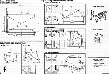

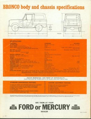

Yo Nathan,
Some dimensions show bed size for early Bronco will be narrower and shorter than full size Broncos;
78-96 Bronco (Full size) Specifications (1980-1986):
Wheelbase: 104.0 in (2641mm)
Length: 180.3 in (4579 mm)  Width: 79.3 in (2014 mm)  Height: 75.5 in (1917 mm).
Cargo Area Dimensions: length (mm): 1,5801 = 62.2 inches and width between arches (mm): 1,290 = 50.78 inches Source: by motortrend.com
Following in mm;
66-67 wheelbase 92"  length 153.8"  width 69.1" height 73"
