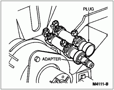

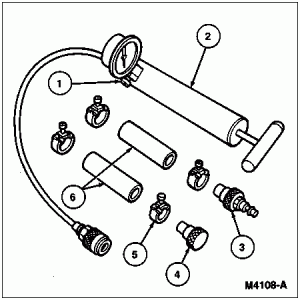

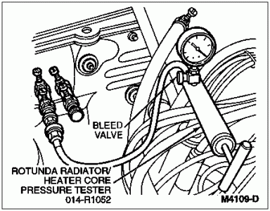

- Insufficient, Erratic, or No Heat
- Low radiator coolant due to coolant leaks.
- CHECK radiator cap pressure. REPLACE if below minimum pressure. FILL to specified coolant level. PRESSURE TEST for engine cooling system and heating system leaks. SERVICE as required.
