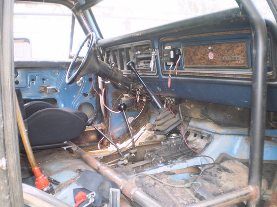

ZF 5 speed swap pic's in a 78 by 78bronco460
http://www.supermotors.net/registry/605/65531-4
http://www.supermotors.net/getfile/853535/fullsize/p8020257.jpg
"In that picture the trans is in 1st gear, and it's not a bad reach. I've been trying different lengths and bends, mostly because of the throw, but I have three other shift sticks (for the t-cases) to consider."
