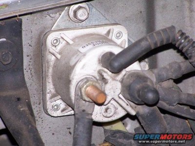

Here is Ken'so 1990 Bronco pic showing the inner fender mounted relay;

So is this wrong? The thick wire( I used the wrong term, not ground) to the starter is hooked to the positive terminal on the battery and that smaller wire on the left post on the starter relay is hooked to the small terminal on the starter.
Rons beast
Dec 13, 2007
1,537
Ok...I think I'm getting an understanding of your wiring.
Let me review:
1- There is a heavy gauge wire running directly from your starter motor to the + terminal of your Battery...correct?
2- There is a smaller gauge wire running from the left heavy post of the relay on the fender to the starter, attached to a smaller terminal there...correct?
If so this is not factory wiring and not a standard factory starter set up.
This still can be made to work properly.
The smaller gauge wire is the starter activation wire. ( it closes the circuit to the starter motor and activates the solenoid to engage the gear. Like GM starters, as oppose to most Fords that have only the one heavy gauge wire .  The previous owner installed that starter and has attempted to activate it by using the factory relay on the fender as a source of + power to run the starter. (This is what the thinner gauge wire from the relay to starter is for)
To get that starter to turn and do it's job we have to "close the switch" that is the relay on the firewall. that is done by supplying power to the small post at the top. ( the one with the red wire w/ lt. blue stripe)
Normally that wire is energized when the key is turned to the start position and then closes the circuit in the ignition switch. that provides + power to the relay on the firewall, first passing through the neutral safety switch.
Try this:  jump from the battery + to the small post on the relay on the fender. ( the one that has the redw/ ltblue stripe.) It's ok to pull that wire off for this test.
IMPORTANT!!!!    HAVE THE KEY TURNED OFF TO PREVENT THE ENGINE FROM STARTING.
This is only a test for the starter and relay circuit.
Applying power to that small post should make the starter engage and the engine crank.
If it does you only need to find the reason the red/w lt blue stripe is not getting power when the key is turned to the start position.
This doesn't mean everything in the wiring is fine but you will have eliminated the starting circuit under the hood.  (It's a bit carved up but can work.)
Let us know how this turns out.
