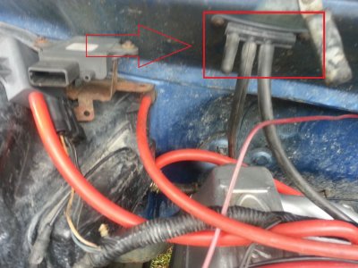

Hello,
I'm restoring this 1988 Ford Bronco Custom with a 302 engine and C6 transmission. While repairing a lot of the damaged vacuum hoses, I noticed what looks like a vacuum tree attached near the windshield wipers in the engine compartment. There are three attachments, one is capped, one is empty, and one has a vacuum line that leads to nowhere. There are similarly cut vacuum lines that appear to maybe connect, one of which leads to the charcoal filter.
If anyone could help me out, it would be greatly appreciated. I plan on re-doing all the vacuum hoses soon, but I'd like to know where everything goes first.
Thanks,
Tyler
yo TYLER,
88 XLT 351W C6 Vacuum Tree Pic by Saltlife (Tree factory location is on the firewallfirewallon  20131012_131104-1.jpg

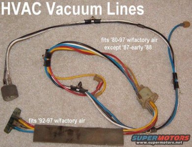

HVAC VACUUM Harness;

yo Tyler,
The vacuum line that attaches to the back left of the engine is most likely the
Air Bypass Valve (AIR BPV)
In the https://www.motorcraftservice.com link I gave you, if you go thru the drill, you'll see the AIR BPV @ top of the vacuum diagram
https://www.motorcraftservice.com/pubs/auxf/~WC/USENIE/1858/E8AEAGA.gif for example for 1988  5.8 CALIBRATION: 8-64E-R00;
It travels to the Thermactor Air Bypass Solenoid (TAB, AIRB, AM1) next to ignition coil
.http://www.supermotors.net/getfile/848247/thumbnail/tab-tad-evr-coil2a.jpg
It may have the Thermactor Air Diverter) Valve (TAD) attached to it in the 5.8; if so TAD line goes to the Thermactor Air Diverter Solenoid (TAD, AIRD, AM2) next to TAB
See these pics;
tab-tad-evr-coil2a.jpg  by Seattle Bronco
by Steve
In the Ford diagram,
ACV (Air Control Valve) is the TAD (Thermactor Air Diverter) .
VRESER is the Vacuum Reservoir Can;
TAB/ TAD Valve located at the rear of the Intake Manifold. You have to climb up onto the engine to feel the Diverter Valve or remove the Intake Manifold. I'd rather climb up using planks, ala a scaffolding type set-up; maybe remove hood depending on circumstances such as me now, w/ backache..."
