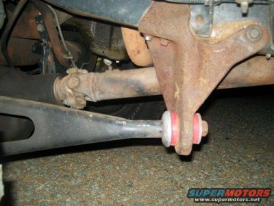

Just received a kit from Bronco Graveyard to replace my radius arm bushings and they look NOTHING like my old ones, didn't come with any instructions. Any ideas in what order they should be placed on the radius arm??? The kit came with 2 flat and 2 concave washers, 2 large bushings which match the 2 old ones on the truck, 2 smaller bushings which have 12 raised bumps around the circumference, and 2 white plastic spacers.

in order from front to rear, flat bushing, small bushing, Bracket, big bushing, curved spacer, curved washer. I'm goin off not lookin, but pretty sure thats the way.
There is a write-up on how to change out those bushings in the Tech Articles forum section. It should be one of the pinned topics on page 1 or 2. Or, if you use the search function, use the " marks before and after your key words, like in "radius arm bushings". JSM84

If you have your radius arm sitting there you will have a metal cup, the large bushing(this one will go into the radius arm bracket), then on the other side you will have that plastic ring, the smaller bushing then the washer/nut.

Thanks for the help, the tech dept. at Bronco Graveyard didn't know what to tell me. Looks like the old bushings are on backwards, the concave washer and large bushing are on the side with the nut. What should the nut be torqued to? I've read 180 lb/ft?
Haynes says 80-120 ft-lbs, but I usually go to 120 as long as it doesn't crush the rear bushing too much. JSM84

I noticed that on the Bronco Graveyard website it mentions that the bushing kit replaces the "welded on washer". The only thing I noticed on my truck is a spacer welded on the back side of the bracket which is about 1/4" thick. The plastic spacer was placed backwards so the hollow portion of the plastic spacer fit over the welded on spacer, then the flat side of the plastic spacer faced the smaller bushing, the flat washer and then the nut. Am I supposed to grind the welded on spacer off of the bracket and place the white plastic spacer with the flat side against the bracket???
I would not grind off that lip or raised area on the back of the frame bracket, since that helps to keep the rear bushing centered. If you have the old nylon/ plstic spacer you can re-use it. You may want to post a link to the specif BG part, too.

Finished the job but noticed the nuts bottomed out at the end of the threads on the radius arms. Doesn't look like the smaller bushing compressed much. Think it should be ok??? Also noticed the pinion seal is leaking, but no other problems with the rear end, is this hard to change?
Looking over at BG, it appears to me that the "welded-on washer" part they mention is the cupped waasher in front of the forward, big bushing. If you get the sequence right (cupped washer, big bushing, bracket, spacer, small bushing, flat washer & nut) there should be about 3/8"-1/2" of thread exposed on the end of the radius arm. If you can't get that arm to pull back far enough, and the nut is flush with the end of the arm, you may either have the sequence incorrect or something is not properly seated. It's often helpful to use a come-along to pull the frontend to the rear so it gives you the right mounting of the bushings. When you go to get a new frontend alignment, you can have the shop check these out for you, and check the torque on the rear nut. The arm may even move rearward slightly when you first drive the bronco, and it's a good idea to check the tightness or torque a few times until it settles in.

From front-cupped washer, large bushing, bracket, plastic spacer, small bushing, flat washer, nut. There is about 1/2" of thread exposed at the end of the arm. It seems like the nut ran down all the way to the end(or beginning) of the threads where the shaft goes smooth. Doesn't look like the small bushing compressed very much.
The rear end is 9".
The rear end is 9".
That sounds right. You don't want the rear bushing compressed too much, just as long as it doesn't spin or wobble around. If that is an issue, you might need another flat washer behind the nut.
