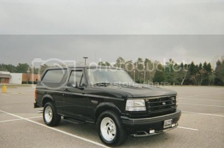

Ron's beast, TTB stands for "Twin Traction Beam", which is the frontend design on the fullsize Bronco. As Roadkill stated, lowering it affects the steering geometry in the same way as lifting it does. If you just install taller or shorter coil springs alone, the geometry is thrown out of whack more than the factory adjustment will allow. you'll get increased tire wear as well as have steering/ hsndling problems. While you can use "Drop brackets" to lower the radius arms and TTB axle beam mounting points when installing a lift kit, it's more of a problem to shorten the stock brackets. You might get an inch or so by re-drilling the bolt holes in those brackets closer to the frame and front crossmember, cut down the stock coil springs, and find shorter shocks. You'd need to modify or remove the factory bumpstops, too. A better option would surely be to remove the entire front 4WD TTB and replace it with a 2WD TIB (Twin I Beam) from an F-150. You will lose four wheel drive, but gain some clearance from the 2WD axle beams. There are a couple of old threads on 2WD Bronco conversions that you might also search for, if they haven't been erased, from the early days of this forum. Good luck, JSM84
Here's an article from FSB linked to in Miesk5's Homepage (see tech articles forum here at BZ) of the Lightning conversion done in 2004 to a fullsize Bronco:
http://fullsizebronco.com/forum/showthread.php?t=68794
