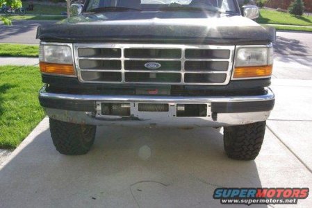

The warn trans4ormer is 1 option as are after market bumbers but most of those go for a grand or more. I went with this solution --
still working on the details for the fairlead through the stock bumper, I kind of like the approch angles without a bumper. More pics here

Let me know what you do about the fairlead on your set up wileec, I just got a Warn 8,000 pound winch that is brand new on trade for a couple old paintball guns, and I have the same bumper as you. I'm gonna try the same setup.

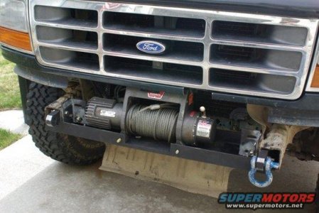

My dilemma is. I have a roller that works well and know how to cut the bumper for it but it will be a big hole under the middle one. But I really want to change to synthetic rope which would mean an aluminum or composite hause fairlead. If I cut the bumper for the roller then change I am worried that the extra large hole would look bad.
Here is what a buddy of mine did on his
I used his ideas all the way down.

Your Buddy's looks clean! I like the way the grill is painted. I think i'm gonna just cut a hole in the middle hole and use the roller fairlead.
