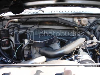

If I'm reading this correctly this is an 86' EFI Bronco. 86' trucks were CFI not multiport correct ? Ford upgraded to MFI with the big nose 4th generation trucks so I'm not seeing how an injector problem would effect a single cylinder. Sure it could make it stumble at certain revs but a miss ? Before getting crazy with anything I'd go back and make sure it IS actually a skip before proceeding any further. Although I suppose rather than just guessing it'd be more appropriate to just ask if the truck is MFI or CFI :) /emoticons/[email protected] 2x" width="20" height="20" />

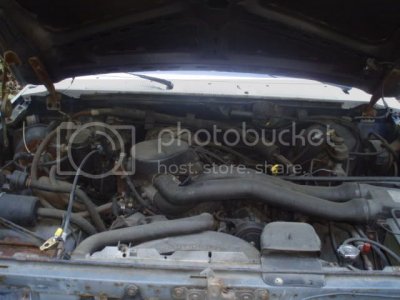

Yes, but is it a throttle body (CFI) or multiport (MPEFI) ? A CFI engine looks like a standard carb'd engine with the usual intake manifold but instead of a carb it has a throttle body (which looks a lot like a carb). 85 & 86 Broncos came stock with CFI, in 87 they switched over to MPEFI. Multiport engines have individual injectors for each cylinder (8 injectors total) and if one goes bad then sure, the engine will start running on 7 cylinders. CFI engines work just like carb'd engines and a clogged or otherwise bad injector will effect ALL cylinders not just one, just like a bad carb. If it's a CFI engine and you're sure that a cylinder has dropped out then you're looking at an ignition problem, if it's multiport then it could be *either* ignition or a bad injector. I understand the engine is fuel injected, I'm just asking if it's multiport or throttle body. It came from Ford with a throttle body back in 86 but that doesn't mean that sometime in the past 23 years someone didn't swap in a multiport setup.

Not the greatest pic but here is my old 86 f150 that was 5.0.
Here is an 89 bronco 5.0

mine looks like the first pic. it has the cold air intake with the filter on the top of the engine not the side. so what one does that mean my engine is. also i figured out the problem cause i just bought the truck like 2 weeks ago and normally i would but the plugs sooner but i didnt this time. but one of the plugs gapping was completely smashed there was no gap. the prong was touching the diod thing or whatever you call it. but now it runs great except for one thing. every once in a while the truck will just randomly die. but will start right back up and drive perfect and wont do it again for like another week or 3. but it doesnt bother me so im not worried bout it to much. thanks everyone for the help
