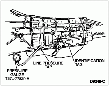

Improper Pressures This is done w/E4OD still in-place
  • Low line pressure
  • Check pressures at line pressure tap. Perform Line Pressure Tests. Refer to Pressure Chart No. 401 for specifications. If pressures are low or all shifts are soft/slipping, go to main controls.
CAUTION: Perform line pressure test prior to performing stall speed test. If line pressure is low at stall, do not perform stall speed test or further transmission damage will occur. DO NOT MAINTAIN WIDE-OPEN THROTTLE in any gear range FOR MORE THAN FIVE (5) SECONDS.
This test verifies the line pressure is within specifications.
  1. Connect pressure gauge to line pressure tap.
  1. Start engine and check line pressures. Refer to the following chart to determine if line pressure is within specification.
  1. If line pressure is not within specifications, perform On-Board Diagnostics and Pinpoint Test E, air pressure check and service main control system or pump as required.
