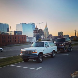

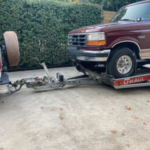

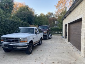

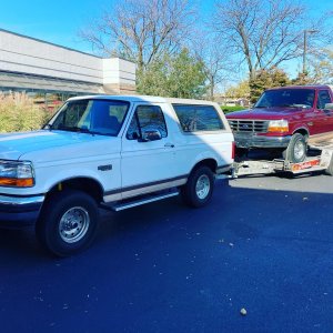

Really appreciate all of your help and suggestions. I made it, but would never recommend it. The trailer sway over 50 mph was horrible so a 24 hour drive turned into a 30 hour drive.

Glad you made it work, and even better to know that a Bronco fits on a U-HauI trailer. I do see how the trailer would be prone to sway. the nose of the trailer is definitely tipp'd down. I think flipping your ball would of helped pick the nose of the trailer up a lil'.
