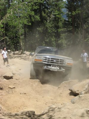

I would not recommend it. This is a result of a bad clutch, on all of the time.
The dust cloud is all from the fan. You should have seen what my air filter looked like after that trip.
