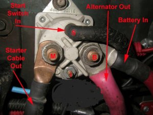

Yo Don,
S = Start (Keyed Red/Light Blue from Ignition Switch)
M = Motor (Cable to the Starter)
B = Battery (Cable from your Battery + Terminal & From Alternator & to Fusible Links
