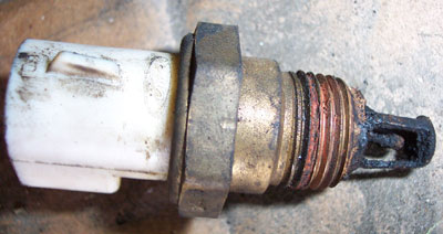

DTC 112 to 114, Intake Air charge temperature sensor (ACT or IAT)Troubleshooting & Possible Causes; "...Codes 112 to 114 will set a IAT sensor code in the EEC, remove and inspect the sensor it could get contaminated by engine oil , K&N oil or dust. Clean the sensor with isopropyl alcohol. If the sensor still fails replace the unit..." Intake Air Temp (IAT); (Air Charge Temperature [ACT] prior to 1992)
IAT will have a connector with 2 wires. looks like it plugs right into the intake tube. to remove it, unplug it and pull it out'
the IAT sensor is installed in the lower intake manifold and in the air cleaner tube on SFI engines.
dirty one will look like this:
http://www.supermotors.net/getfile/104574/fullsize/iats_dirty.jpg
by Big
IAT sensor on the 94 is located on intake manifold near the #6 runner. It screws in the intake manifold itself
