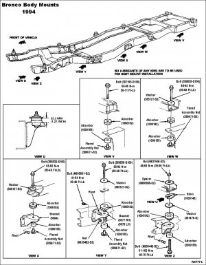

I was asking about the instructions for mounting the the 2017 f-150 crew cab.
Here is the Frame info;
Hopefully we can match it to the instructions for the 2017 f-150 crew cab or find a place on the frame, etc for brackets.
