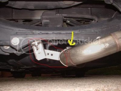

A while back I pulled out my exhaust and ran over it in reverse and bent it around the rear axle and broke the rear rubber hanger that holds the exhaust end pipe befor it torns out the side. I was wondering if they seel those anywhere or if there is a good replacement to keep the muffler up and to replace the rubber hanger, other than a coat hanger or any other rigging materials.haha I went to the junk yard taday and pulled the exhaust piping I needed of another bronco but also the hanger was ripped along with the few othere broncos and trucks there. thanks

They mount to the pipe with an exhaust clamp. I use them for all my trucks.

I have a hanger on the pipe. I just need something to connect the hanger to the frame. I'll check out a few auto places tomorrow about that setup in the picture. Thanks guys.

the original rubber hanger is still available I think I got mine at napa. But on my '90 the bottom of the rubber slides onto a rod that is welded onto the pipe, that's fine, but the top of it is held by a braket loop that is riveted into the frame. I'd have to get a cut wheel up in there or something to get it out.
Sounds like a trip to the muffler shop is the way to go. :) /emoticons/[email protected] 2x" width="20" height="20" />
Found that Walker is prob the OEM for Ford since their bracket, donut, & strap are exact fit. Bought from Advance Auto.
For future reference:
35502 Bracket $8.99 Mine bolted in
35564 Hanger $12.99
35460 Insulator $3.99 Rivet Must be Drilled Out of O.E. Hanger
Got mine at Advance Auto;
And found Stainless Steel Universal Muffler Hanger Kits by PCI Inc order their free catalog - great customer service as well!
