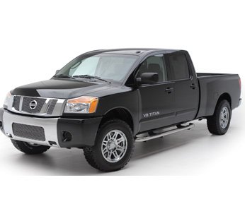

You said its stock height for now, you may want to look at nerf bars to get in, she may need them too when you lift it.
yo Bronc76!
Great!
I completely forgot about Nerfs! Even tho that is what I put on our 96 to help my much better half to jump in and para out.
I got the Smittybilt Nerf, $105.00 in 97 w/free S&H; powdercoated black; here it is:
You may find these still avail at parts stores; SB re-organized and dropped these basic round tubed Nerfs.
BTW, they did a great powdercoat on it; after 13 years there is no rust on it and look great, exc. for minor scuffs that come out w/buffing.
Here is the SB Nerf line-up
for our Broncos; the Smittybilt Sure Steps are close to what I have & their other Nerfs don't appear to be applicable according to their lists.
BN300-S2B 1980-1997 Ford Bronco 2 gloss black BN300-S2S 1980-1997 Ford Bronco 2 stainless steel
