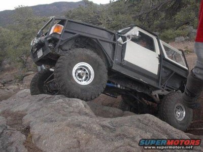

I'm running a 10-point rollcage kit made by S&W Racecars made out of 1-5/8"x0.135 wall tubing that I installed myself. I do have a very detailed write-up on that in the Tech Articles forum, and about 80+ pics at Supermotors.net gallery for my 84 Bronco. There are important safety issues when installing a cage that you should be aware of, whether you put one in a daily driver, mud drag truck or rock crawler. The design of the dash on the 97-up Broncos makes for a bit less room inside with a full cage, too.
Last, the removable door mod is very simple, and I've done it to both the 84 and 78 Broncos. I use 4.5" long, 3/8" bolts in place of the pins on the door hinges. I also built a set of tube doors for the 84 out of two Bronco rear tire carriers. I like wheeling without the doors, since I have a habit of leaning out a bit to watch my front-driver's tire when offroading. The tube doors give me that option with a little protection from the trees. JSM84
