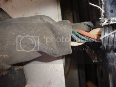

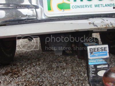

Hey guys, does anyone have any diagrams of the trailer towing wiring harness that connects to the plug insert below my rear bumper of my 95 Bronco? That's a better alternative for me then to test every wire I see. The problem that I'm having is when towing a trailer my running lights on the trailer are dead. The turn signals and the brake lights work, but when I turn the headlights on, my trailer lights won't illuminate. I'm thinking it's a ground somewhere, but I don't know which color wire to trace that controls the running lights, and there's a great big bundle of them that dissapears underneath my gas tank. I know the problem is in the truck and not the trailer. Thanks in advance, Jeremy

Thanks, I printed that out 2 weeks ago and went out to the bronco, and nothing underneath there looks like that diagram. I guess I'll have to test each one and find out where each goes and what it does. Thanks again.

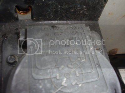

Well, it turns out I looked into the wiring harness way too far. All I had to do was look on the plug cover, and there was the diagram I needed which pointed out the running lights.
It's yellow btw. I have no idea where it goes and how far I need to trace it but at least I know which one it is now.
