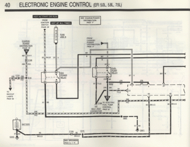

Wiring Diagram in an 89
Consider  EEC & Fuel Pump Relay Swapping to Bosch Style Relays & Color Codes in all pre-'92 EFI Bronco & F-series; "...Working on ONE relay at a time, remove the terminals from the stock connector & discard it. I collected these Bosch-style sockets in junkyards, but they're available at most parts stores, from Ford, or several online suppliers like RJMInjectionTech.com as crimp-on kits for a near-factory look. Being careful to connect the wires to the proper terminals (using the list below), securely connect the old wires to the terminals of the new sockets. Try to keep the wires the same length so there's not a huge ratnest. EEC PWR 30 - Y (battery always 12V) 87 - Bu, DB, R (out to EEC) 85 - Wh/LB, R/LG (12V in from ig.sw.) 86 - Bk/LG, Bk (ground); FP: 30 - Y (battery always 12V) 87 - Pk/Bk, Br, DG/Y (out to inertia sw.) 85 - R (12V in from EEC PWR relay) 86 - T/LG, LB/Or (ground from EEC)...It's OK to reverse 30 with 87, or 85 with 86 on either relay. It's possible to just use common insulated flat blade terminals to connect the bare wires to the relay terminals without a socket, but it's not as secure or convenient. Now the truck will be MUCH more reliable, and can use the cheaper, heavier-duty, more common ISO relays that are easier to swap. Tape up the harness & secure the relays to a safe mounting location. Not all relays have mounting tabs like these, but the sockets or harness can be zip-tied to something solid..." @ http://www.supermotors.net/registry/media/507187
