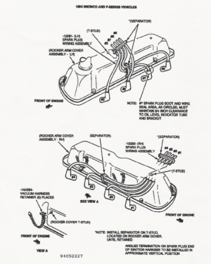

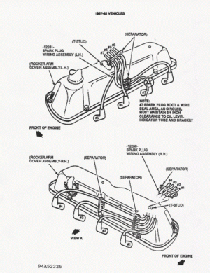

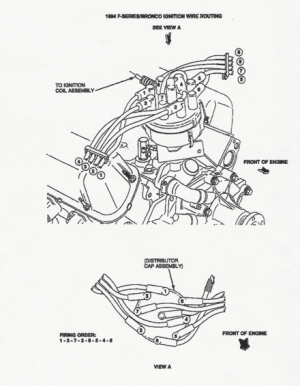

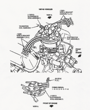

The firing order for 1987-1993 5.0Ls is 1-5-4-2-6-3-7-8. If #7 and #8, or #2 and #4 spark plug wires are routed next to each other at the separation bracket, an induction crossfire condition can occur.
To eliminate the possibility of the coil wire becoming disconnected, route the coil wire under the spark plug wires at the distributor cap.
Images courtesy of Tank92!
