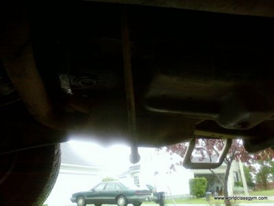

Here is a bad image of the piece that came apart. I was able to put it back in place to get home but then it fell out again. Is this something that can be pinned in place?? :blink: :huh:

Here is a better picture. The end of the bar hanging down is supposed to be in the bracket to the right. I am able to put it back in there but there is nothing to hold it there.
Here is a close up of the end of the bar. it looks like there can be some sort of retainer ring or something that can go on it but I am not sure what is supposed to hold it on. got any ideas?
