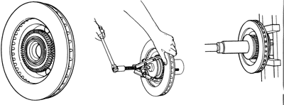

I ordered new spindle hubs and rotors because my old spindle teeth were grinded to ****. When I received them on the inside of the spindles there is this metal gear with teeth or something on them, they can mount and be used fine with this piece there, but I cannot figure out what it's for as the old ones didn't have this. It's a 1990 bronco manual locking 4wd. Can anyone help identify this piece?https://photos.app.goo.gl/qzVmCSy9EENdgxJy7
https://photos.app.goo.gl/GhgHeT23MgwBEhV38
https://photos.app.goo.gl/NbKS4kELiNFrr7p28
Yo Willy,
My vision is poor and my tablet shows fuzzy pics.
That's the 93-96 4 wheel front anti-lock Brake speed sensor toothed tone rings.
Front wheel sensor ring, 4-wheel ABS
btw,  "using a 3-jawed puller, remove the ring from the hub. The ring cannot be reused; it must be replaced."

Thanks! I'll take those off before mounting them. Much appreciated, for some reason I couldn't find what they were anywhere online, thanks again!
