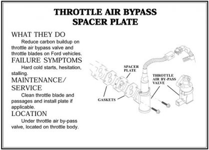

A PLUGGED IAC or  passages in throttle bodybody can cause the issues.   See IAC gasket trim by Nelbur here @ http://broncozone.com/topic/22150-fast-idle-problem/?pid=115710
Key phrases by Nelbur; "...idle is also "hunting" ...
on that page notice TSB 91-25-07 IAC Sludge; Poor Idle...key phrase is "rolling idle"

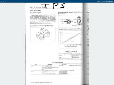

Yo TheMilesMiller,Screenshot_20200503-104531.jpgthrottle-body-air-bypass-spacer-plate1.jpgScreenshot_20200510-111313.jpg

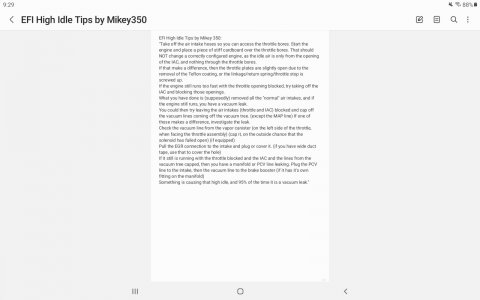

In event issue still occurs;
